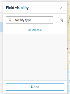

2. Attribute Expressions do not display within the table in the Web Map Viewer. There is not an option to turn them on or off in the Field Visibility tab within the table:

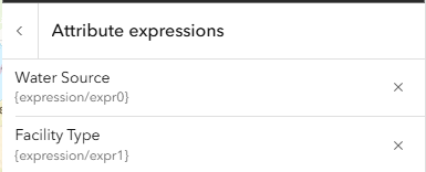

3. Attribute Expressions populate in the pop-up of a Web Map added to an Experience Builder:

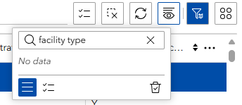

4. Attribute Expressions do not populate in the Table Widget in Experience Builder, nor are they present in order to turn visibility on or off:
