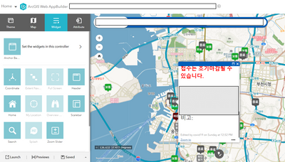

The customer wants to remove "Add a Marker" fuction on pop-ups found on Web AppBuilders for security.
The customer uses Portal for ArcGIS 10.8.1. This issue occurs the same on ArcGIS Online.
It is a default function that shows XY Coordinates of the points on the web map used in Web AppBuilders (both on edit page and view page).
It is not found on web maps, but on Web AppBuilders.

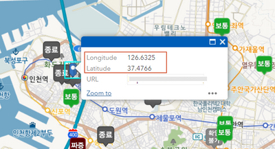

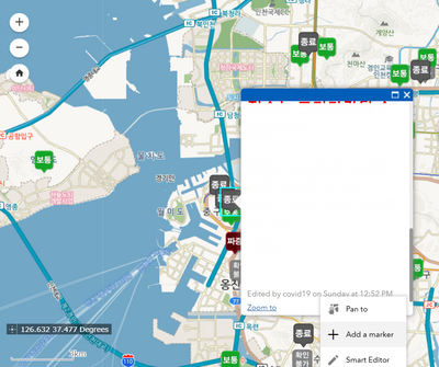

1. Click any point feature to see a pop-up on the web map included in Web AppBuilder.
2. Click ... on the pop-up.
3. Click "Add a marker" and click the blue pin created.
You can see the Longitude and Latitude of the pin point.
