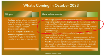

TonghuiMing
This has been provided in the AGOL 2023 October release.

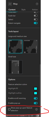

@DavidWittmann  I must be blind. I've been fiddling with the search widget for almost an hour and cannot see how to enable pop-up from search results. Would love a tip.
JeffreyThompson2
@ChrisChappell1 In the Map settings, scroll all the way to the bottom and select Show pop-up upon feature selection. This feature was added in Experience Builder 1.13 and is not currently available on any version of Enterprise.
