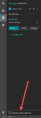

Hi Trina,
You can set a default view by check the option View for empty selection on the feature layer settings of the Data panel.
Please see details at https://doc.arcgis.com/en/experience-builder/build-apps/select-data.htm#LI_4B52CC64D110465C91A6F404B...
Regards,
Shengdi

Exact same scenario I have and this is exactly the answer I was looking for. Found what I need in 2 minutes thanks to Esri Community. 😍
