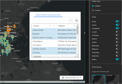

The Map widget has a select tool setting that provides a selected features count at the bottom of a map. If you have a table and a map connected to the same data source, selecting features on the map will select them in the table and vis versa and show up in the count. Here's a screenshot of the Map widget's settings and the feature count.
