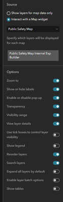

lmurrayADOT
Glad to see this was implemented.  Thank you.  @TonghuiMing, just curious, are there plans to provide the ability to expand only specified groups?
MattiasEkström
@TonghuiMing
It's great that we can finally expand all layers by default, but like ImmurayADOT and others I'd really like to have full control over which layer groups are expanded and which aren't.
In my case, I especially want to be able to have map image layers expanded and their sublayers collapsed.
LindseyStone
I second, third, and fourth @MattiasEkström comment.  When I have a map image service added to a map that has several layers within it,  I would prefer to have this initial map image layer expanded by default,  but all my group layers under that not expanded.  The ability to pick and choose would be awesome or the ability where it recognize that it is a map service and allows the expansion of that by default.  It is so annoying that in map layers widget you just see the service main layer and have to expand from there.
Brian_McLeer
I have the same situation that @MattiasEkström and @LindseyStone are wanting to have implemented. I copied the out of the box widget and customized it to have the parent group layer expanded by default, but group layers within collapsed. Having this functionality out of the box would be much easier to maintain.
