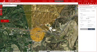

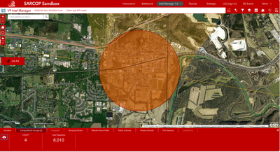

Real-world Problem: First responders, especially Urban Search & Rescue Teams, do not usually have a GIS Specialist on their team. For no notice events like a hazardous material release or other threats, they need to know what areas are impacted in the shortest amount of time possible.
Technical Problem: Since 2012? Esri has provided the Emergency Response Guide (ERG) widget, first through the iconic Flex Viewer and then through WebApp Builder (WAB). In 2023 we are beginning to move from WAB to Experience Builder (ExB), but the ERG is not shown in the road map. This is preventing us from adopting ExB and forcing us to explore other options.
Similarly, the Threat Analysis widget is growing increasingly relevant but also not in the road map.
Potential Solution: Implement the ERG and Threat Analysis widget in ExB. These widgets could be hosted as part of a "template" or even hosted in a public app available to first responders. Their home agencies, if they have GIS staff or Esri Professional Services, can embed then app into their own viewers and workflows.
These widgets provide a great capability that I believe first responders were only just starting to discover and appreciate. It is also a great opportunity to revisit the end-user experience and connect it to other existing widgets like the "Near Me" (formerly known as Situational Awareness widget) for more powerful impact analysis.
