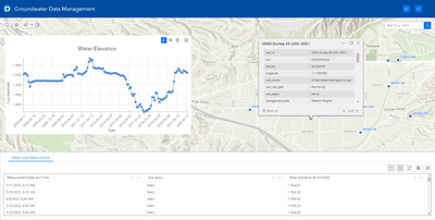

MattPalavido
This isn't ideal but it has worked for us in the meantime. We've added a text field to our data and calculated using an Arcade expression:
Text($feature["measurement_date"], 'YYYY-MM-DD')
You can also add an attribute rule to this attribute to auto-calculate the date as a string for any new records added.
