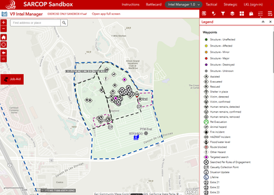

The screenshot below shows an example incident within SARCOP with about 60 points.

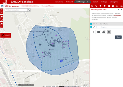

See below, the user can choose to select a group of points by drawing a freehand polygon.

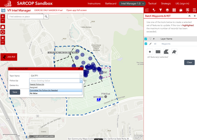

 In the screenshot below, the points in the selection polygon were selected and the user can update attributes for the group of points all at one time.

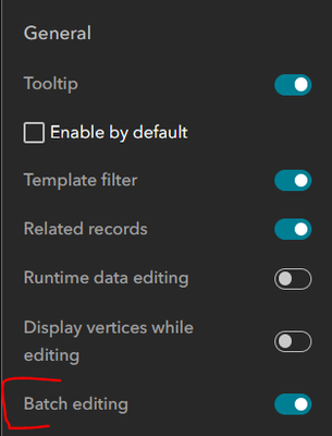

Hello, I see that there is now an option to check "Batch editing" when the edit widget is in "Interact with a Map widget" mode.  Thank you!

Batch editing is now available in the Edit widget when using "Interact with a Map widget" mode, in Experience Builder in ArcGIS Online. Enable the option in the General settings.
