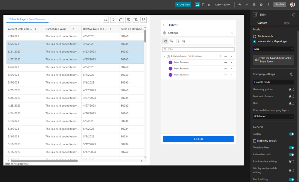

A workaround may be to hide the Map on the page and use another widget to select features, such as the List or Tables widgets which also support multi-select.
For e.g. below, I hid the map behind the Table widget. Note that I don't recommend this as a best practice, maybe more like as a "hack"...
