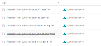

Allow pages in the same project to have the same name section name.
For this project https://experience.arcgis.com/experience/c6fde5fd914d407aad18c07cc7725d6a/
I had to create separate ExB for each tick because I couldn't have a distribution section for each tick. Some of the pathogens repeat across ticks too - so even if we did 'Specific Tick - Distribution' I'd have to do 'Specific Tick Really Long Pathogen Name' which makes formatting menus harder.
Having more ExB's mean's managing more portal items and it makes it hard to make minor tweaks in header and footer, now I make those 5 times.
Screen captures of ExB structure I used to make this work below.
