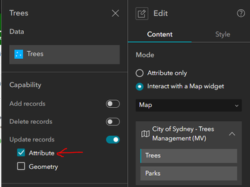

For attribute only editing, you still have the ability to customize the editing capabilities for each layer in the map.
Make sure you only allow for Update records > Attribute in the layer's capabilities. Example below:
AlixVezina_0-1751469954630.pngAlixVezina_0-1751469954630.png AlixVezina_1-1751469975474.pngAlixVezina_1-1751469975474.png

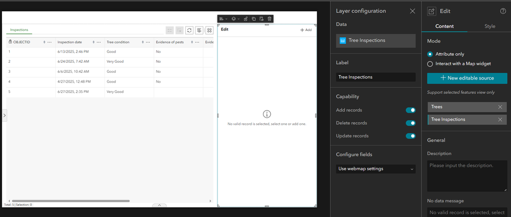

When configuring the Edit widget, you will find two modes are available:
  • Interact with a Map widget - the Edit widget will only read the feature layers from the maps in a Map widget for editing. This is similar to what was available in the Batch Attribute Editor widget in Web AppBuilder, where a map was always required in your app for the widgets to work. This newly introduced batch editing option in the Edit widget allows editing the feature's attributes and also their geometries. This was the main workflow the Experience Builder team was focused on supporting for batch editing in this initial release of the functionality.
  • Attribute only - you can connect the Edit widget to any editable layers in your app, may they be in a map or not. This option only allows you to edit the attributes for features (in a feature layer) and records (in a table layer) - it does not allow you to edit geometries in the map. Technically, with this option, you could build an app with only a Table and the Edit widget and no map at all (example below). This is a new type of workflow that we did not previously support in Web AppBuilder. The team will add support for batch editing in this case too, in a future release, so you'll get the new ability to also batch edit records from a table layer.
I hope this all makes sense! 😊

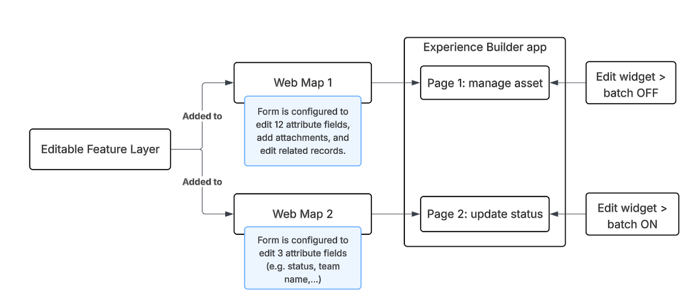

AlixVezina
Hi @ConorFlynn,
I think providing field customizations for Batch editing at the widget level is under consideration. The recommended approach for customizing your editing experience remains to configure editing Forms for your editable layers. See: Configure forms for attribute editing (Map Viewer)—ArcGIS Online Help | Documentation
Since it is possible to create different Forms for a same layer in different maps, I suggest creating a map tailored to your Batch editing workflows and customizing a Form for batch editing.
Just a quick example to illustrate what I mean:
ConorFlynn
@AlixVezina - Thank you!  I hadn't realized that editing forms would come through in Experience.  That does seem like it could work for us.
Instead of multiple maps/apps, I think we could also add multiple view layers on the same map to allow configuring different forms.
Thank you for hanging in there to understand our need and explaining this workflow.
