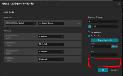

@TonghuiMing Hi Tonghui, could you offer additional insight on the "List Values Based on" function for Group Filters? It's the bottom right dropdown in your second screenshot. Are there specific prerequisites for this option to appear? It doesn't show for me in my window and I can't find anything in the documentation regarding possible limitations/requirements.
For context, I'm using fields that are all text, the "Unique" source type option is set for the Operator, and I have other Filter widgets within the app (not just multiple clauses within one Filter widget ...though I tried that too).
TonghuiMing
Hi @AaronKoelker
The setting could exist after the 2024 Mar release, but then we removed this setting a few days later (it does not make much sense in group filter settings). If you have the app configured during that period (about a week), then it might show the former configurations.
You can refer to the details in - https://community.esri.com/t5/arcgis-experience-builder-questions/stacking-group-filters-not-working...
This should not happen for newly created apps, and it should not appear if you configure it again. Let me know if you still encounter this in a new app; if so, we can look into it. Thanks!

@TonghuiMing Thank you for answering so quickly, I'm happy I can at least stop fiddling with it for now and wondering if it was user error on my part.
I do somewhat agree with @D_Atkins, though. Or at least, it's unclear to me why the option doesn't make sense to implement. I saw in your linked post that it was removed to avoid confusion since the behavior always acted as "All Values" regardless. But the behavior I'm seeing is that it doesn't react to any values based on what's selected in other filters. You also mentioned it is only for clauses within a single set/group, so perhaps this is a broader issue I'm confused about or a misunderstanding of what those options are really doing.
So if I have one Filter widget with a single clause, and another separate Filter widget with a Group Clause, there is currently no way for the Group Clause dropdown values to react to what's been picked in the Filter widget with the single clause?
Edit: Apparently my issue in the question above was related to having multiple filter widgets connected to the same layer, which I assume now meant the group clause I had in the one widget wasn't limiting it's dropdowns because those values were available in at least one other filter that was still set to -All-. Still not 100% sure of the behavior.
