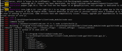

Hello @Jianxia  - Before I upgraded EB1.7 to EB1.8, I ran an update to my node js environment to v16.14.2.
I then ran the client install from the /server directory and launched the app at https://localhost:3001/.
I then ran the client install from the /client directory and it is returning a whole host of errors:
npm ERR! code 1
npm ERR! path C:\ArcGISExB18\client\node_modules\node-sass
npm ERR! command failed
npm ERR! command C:\WINDOWS\system32\cmd.exe /d /s /c node scripts/build.js
npm ERR! Building: C:\Program Files\nodejs\node.exe C:\ArcGISExB18\client\node_modules\node-gyp\bin\node-gyp.js rebuild --verbose --libsass_ext= --libsass_cflags= --libsass_ldflags= --libsass_library=

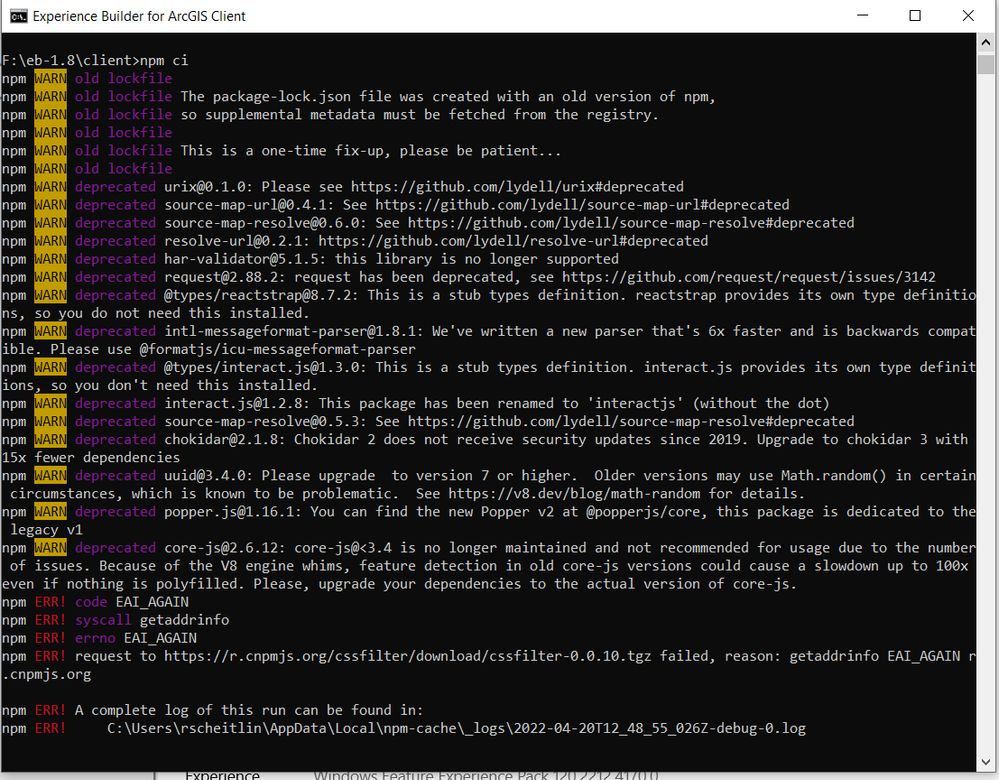

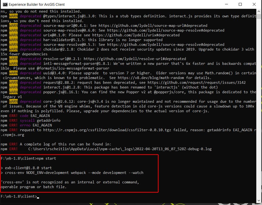

I am also have this issue. I did a install of the latest NodeJS (from the eb install link on your webpage) 16.14.2 on my Windows 10 (Pro 21H1) 64bit.
When I did client install I got lots of depreciated warnings
server ci produced 4 vulnerabilities, so I ran npm audit fix --force and then everything was fine.
Even after running a npm audit fix --force on the client directory and running npm ci again once I do npm start I get a 'cross-env' is not recognized error.
Let me know if you need any further details.

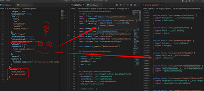

In your dev environment are you have any issues with the typeScript definitions? On my end 1.7 and before is fine but 1.8 does not know what __esri or really anything JS API. I have checked for differences in the tsconfig and I can only see the addition of the calcite-components stuff in 1.8
babarsac
@RobertScheitlin__GISP
No issues on my end so far. This was a clean install of 1.8 in a connected environment so I didn't have to manually install the JS API.
DougLogsdon2
I had this issue using VS Code, and likely after importing my custom widgets. The issue was that there were too many files to scan.  Adding additional folders to tsconfig.json's exclude fixed the ensuing problems for me.
MVP Emeritus
@DougLogsdon2
OK do you mind sharing your exclude array?
DougLogsdon2
This was sufficient for me:
"exclude": [
    "node_modules",
    "arcgis-js-api",
    "dist",
    "__mocks__",
    "jest-systemjs-transformer.js",
    "jest.config.js"
MVP Emeritus
@DougLogsdon2 ,
Thanks. I had to take it a little further before it would work for me.
"exclude": [
    "node_modules",
    "arcgis-js-api",
    "dist",
    "__mocks__",
    "jest.config.js",
    "jimu-for-test",
    "webpack.config.js",
    "webpack"
ChristineWiltawsky1
@RobertScheitlin__GISP @DougLogsdon2
I had the same issue in VS Code. We fixed it by setting the allowJs flag in tsconfig to false. This param was added to tsconfig.json with 1.8. Maybe this is the reason that there are too many files to scan, because js.-files are included.
esride-nik
@ChristineWiltawsky1  @RobertScheitlin__GISP @DougLogsdon2
Yesterday this was totally reproducible:
  • setting allowJs: false in ExB 1.8 => errors are gone
  • adding allowJs: true in ExB 1.7 => errors are coming up (no imports found and linter issues in arcgis-js-api.d.ts)
I was able to switch between those settings and allowJs always caused the same issues in both latest versions of ExB.
Today: allowJs: true in ExB 1.8 => no errors. Even after a couple restarts of the Eslint server, the TS server and VS code itself.
Does anyone know if there's some kind of caching mechanism in VS Code that somehow remembers modules that could be resolved once? Or did it just have enough time to finish scanning everything?
I don't like when things are unreproducible 😕
MVP Emeritus
@esride-nik
I changed the allowJs to false and reverted my exclude array to the default and now everything is fine in vs code. If I set it to true then I have to exclude several additional directories for VS code to not complain. But the strange thing for me today is that EB asked for my portalURL and clientId again and once I did that my seven applications that I moved over from 1.7 using the recommended upgrade process suddenly showed up in 1.8 when they would not before no matter what I did. But now the new app I created in 1.8 (because the others would not show up) is now not listed.... There are just to many variables here, VS Code, NodeJS, ESRI, 3rd party node modules, etc. Something changed...
esride-nik
@RobertScheitlin__GISP  Maybe your applications got lost on the way before because something was not right with the installation. But as you're saying, there's too many variables. Also, why did a shorter exclude array do the job for @DougLogsdon2? Maybe simply because he had his VS Code open for a longer time before so the webpack stuff was already scanned..?
Any thoughts on this from your end, @Jianxia?
AndreasEugster
For the client npm ci problem: I was running into the same errors mentioned above @DavidColey , for node 14x as for 16x. Normally I have to use company proxy server from the internal network. So far never a problem within the development context, for "ExB-Dev 1.8 client npm ci" apparently it is.... although all proxy settings, envs and configs are set correctly.
External internet access without proxy & npm ci in clientfolder has resulted in clean installation (apart from the mentioned  verbose and critical vulnerabilities by @babarsac!). Even without having Visual Studio installed.
DavidColey
MVP Frequent Contributor
So I know this is frustrating bringing this back up, but at version 1.9 client install problems still exist.  For me, the entire /client/node_modules directory did not install with the npm ci, as with version 1.8.
I am copying my node_modules directory from my 1.7 install.  Then we'll see what fails I suppose.
@esride-nik
@babarsac
DavidColey
update
Our EIT security disabled github access for administrative accounts.  since I always work using my admin account, the client install could not access any of the node_modules.  switching to a non-admin account and re-running the client npm ci then did complete it's install, albeit with the same visual studio dependency errors....
ChristineWiltawsky1
Hi @DavidColey
I solved my visual studio dependency in 1.9 errors with following solution:
https://community.esri.com/t5/arcgis-experience-builder-questions/exbuilder-1-9-issue-with-typescrip...
tigerwoulds
I too was getting this error when trying to run npm ci from the client folder. Although I was trying to install Experience Builder 1.9.
npm ERR! gyp ERR! find VS You need to install the latest version of Visual Studio
What I did to resolve:
  • Install Visual Studio, not Visual Studio Code - I did not realize these are two different things
  • Once VS is installed, use Visual Studio Installer to modify the install and add on Desktop Development with C++
  • Then, uninstall node.js 18.21.1 and install 14.21.1. Made sure to uncheck the box for Chocolatey.
Hope this helps someone down the road.
FredericPoliart_EsriAU
I am trying to install Experience Builder 1.9 Dev Edition on a clean system (Win2019 server 32GB RAM)
* installed node-v16.13.2-x64.msi   - no problems
* unzipped arcgis-experience-builder-1.9.zip  in C:\arcgisExperienceBuilder\  - no problems
* run npm -ci in the \server folder - no problems
* run npm -ci in the client folder - FAIL!
I have tested the suggested options in this thread.  -- nothing works
I have just done the exact same on my (clean) laptop and that works fine.
the problem above seem to only happen on customer's Windows server 2019 machine .
There is no VSCode nor Visual Studio installed (and there will never be on that machine)
I tried several versions of NodeJS,  I tried ticking on or off the chololatey option during the install.
I am not trying to clone the entire folder from a known, working system --
Q#has anyone tried installing NodeJS without the tick option (chocolatey) and then manually install from https://github.com/nodejs/node-gyp#on-windows ?
tigerwoulds
@FredericPoliart_EsriAU I had the same issues with 16.x and 18.x versions of node. I removed those and installed 14.21.1 and made sure the chocolatey option was unchecked.
DavidColey
Hi @tigerwoulds - I don't suppose you know if your method still applies at Eb Dev 1.10 - as far as the node version goes?  Definitely will be moving from VSCode to VisualStudio though - Security really dislikes the Chocolately as do I.
