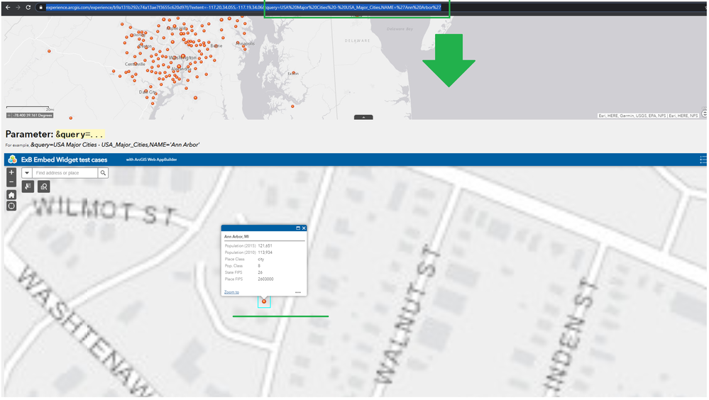

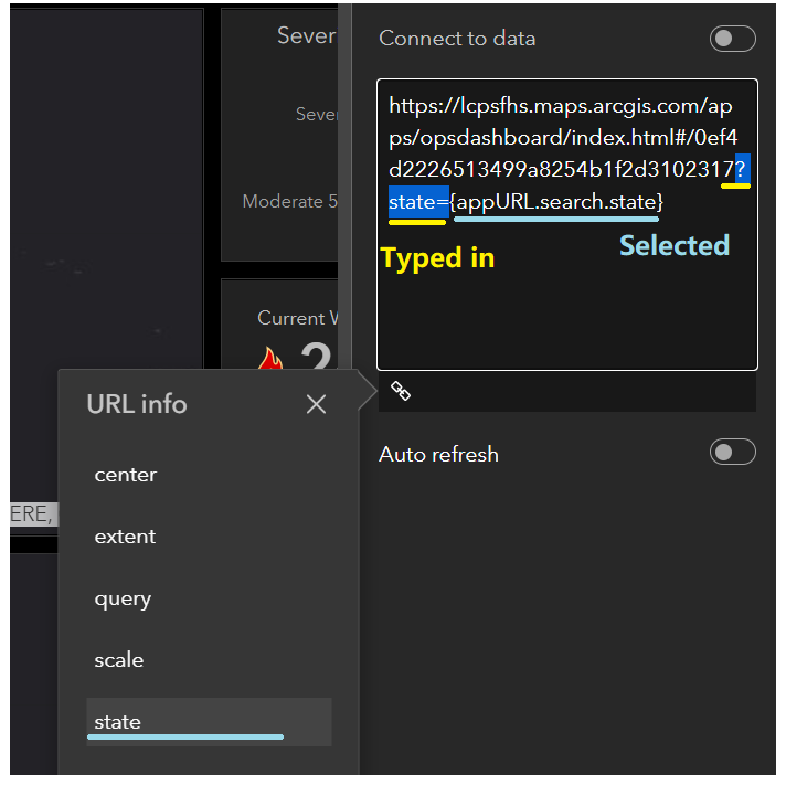

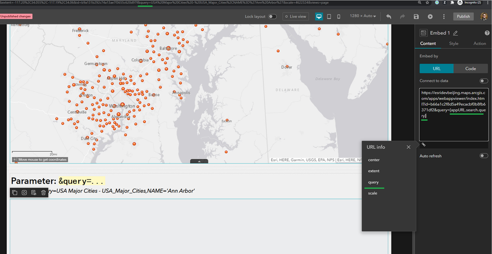

  1. After all the above information is ready, create an ExB app, drag an Embed widget to the canvas, save the app;
  2. Now, add the desired URL parameters that your embedded content is going to use to the ExB builder URL, in the browser tab, then click Enter to refresh the builder page to take effect, like this:InkedFinalExBURL_LI.jpgNote: there should only be one '?' in the URL parameters. The following ones should be changed to '&'.
  3. Inside your Embed widget, type your URL and the &query= part, for example, and then you will be able to open the URL info panel and add the app URL info as the value of this parameter at runtime. Note that the URL info generated by user selection will be in the format of {appURL.search.xxx}.
  4. After all the content being configured, save the app, and run preview mode. Note that preview will not inherit your builder URL parameter for now so you would need to add them on later.
  5. In the previewed app, all URLs will be removed now, so the added URL parameters for the embedded content shall be not affected, instead, it will show the content as it is without any URL parameters.
  6. Now, add any of the corresponding URL parameters added previously, and refresh the page, you can see the one that used the corresponding URL parameters will take effect and pass it to the embedded appRuntime_to use the URL parameters.png

1. Embed Case1_How to use the app URL1_WAB
End-user cases:
https://experience.arcgis.com/experience/b9a131b292c74a13ae7f3655c620d97f/?query=USA%20Major%20Citie...
...(can change per user's request and then show the different cities here)
2. Embed Case1_How to use the app URL2_embedDashboard
End-user cases:
https://experience.arcgis.com/experience/9b69e6e7a6984952944d0410ac9b1872/?state=Michigan
https://experience.arcgis.com/experience/9b69e6e7a6984952944d0410ac9b1872/?state=California

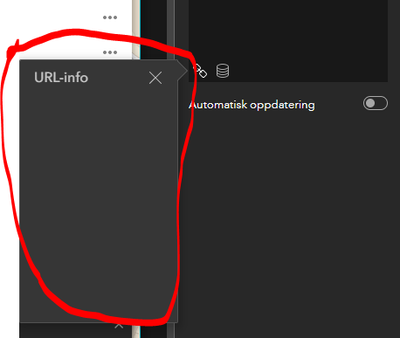

Hi there!
seems like url-info have broke.
TonghuiMing
@BymiljøetatenOsloKommune You will have to manually put the desired URL parameters in your app URL to make it work. Please refer to the detailed steps provided above.

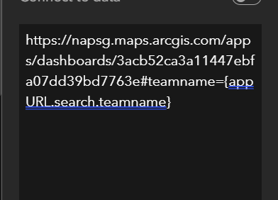

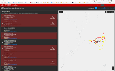

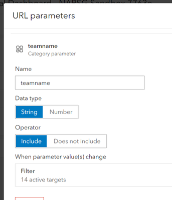

Came here in reference to this post I made https://community.esri.com/t5/arcgis-experience-builder-questions/url-parameters-in-experience-build... @TonghuiMing
I can't seem to get this working for Dashboards. Am I doing something wrong?
My dashboard is set with a parameter 'teamname" which filters everything by the field 'team_name_filter". Works fine on dashboards, but when I copy it into ExB I keep getting No Data messages. Any ideas?
Dashboard Parameters:
URL for the embedded dashboard
URL and what shows up
https://experience.arcgis.com/experience/9051a07ffd1947bbb395e9f9b4088f85/page/Tactical/?teamname=TX...

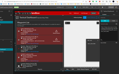

TonghuiMing
Hi @AFackler_NAPSG - I checked your app above, and it appears that the Embed widget on this page does not configure to use any parameter at all:
Maybe you can refer to the steps in this post and try again? Note that any manually typed-in bracketed content will not be picked up, you need to use the URL info panel and then save the app, otherwise, the changes won't be recognized by the Embed widget.

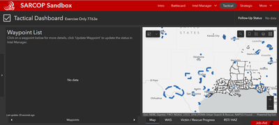

AFackler_NAPSG
I had to switch it back to the base URL since it broke the dashboard if I had the URL parameters in there (it would show the widgets as "No Data" seen in the screenshot which we can't have for a long time since this is used by teams for exercises).  I think I see what I'm doing wrong, I'll comment back when I have something
AFackler_NAPSG
@TonghuiMing Okay getting closer I think.
I read the above closer and finally got the team name filter to appear in the URL Info list and it doesn't break the app when I have no filter on there. However when I try to put a filter on, nothing happens. Any suggestions?
trying with the team name filter = MO-TF1. On the dashboard itself it would filter the data for that team only
I appreciate the help, if we can get this working we can make it so the teams can easily filter the whole ExB by their team and help limit confusion
