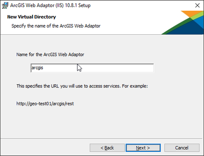

I started off with installing the web Adaptor for ArcGIS Server. I named it arcgis:

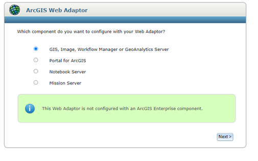

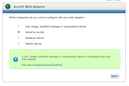

Then after setting up the IIS, I re-opened the web adaptor application and configured it for Portal:
As a result Portal is accessed through: domain.host.com/arcgis/home or domain.host.com/arcgis/portaladmin/
ArcGIS Server is accessed through domain.host.com/arcgis/manager or domain.host.com/arcgis/rest/services

You can configure ArcGIS Web Adaptor to work with a server site ... or ... Portal for ArcGIS.  ... You cannot configure the same Web Adaptor with multiple components.
There used to be no real concerns with using say 'arcgis' as the context.  From about 10.6.1 it was recommended not to, although one of my clients was using it up to 10.7.1 and it worked fine.  When they wanted to go to 10.8.1, the above link showed that the approach was no longer supported.  I implemented this in a dev environment and it broke.  We ended up having to do a new build of ArcGIS Enterprise at 10.8.1 in a side-by-side configuration.  I strongly recommend heeding the advise in this article and using portal and server as the context names rather than trying to put both on arcgis.

Despite the documentation saying you cannot configure multiple components, the setup of 10.8.1 did allow me to do so. Also, I had no issues accessing the Portal and AGS URLs through the same web adaptor name. Although I am reverted it and installed a separate WA for each,  it's intresting to see everything seem to work. SSO login was not set up yet; maybe that is why it still worked?
