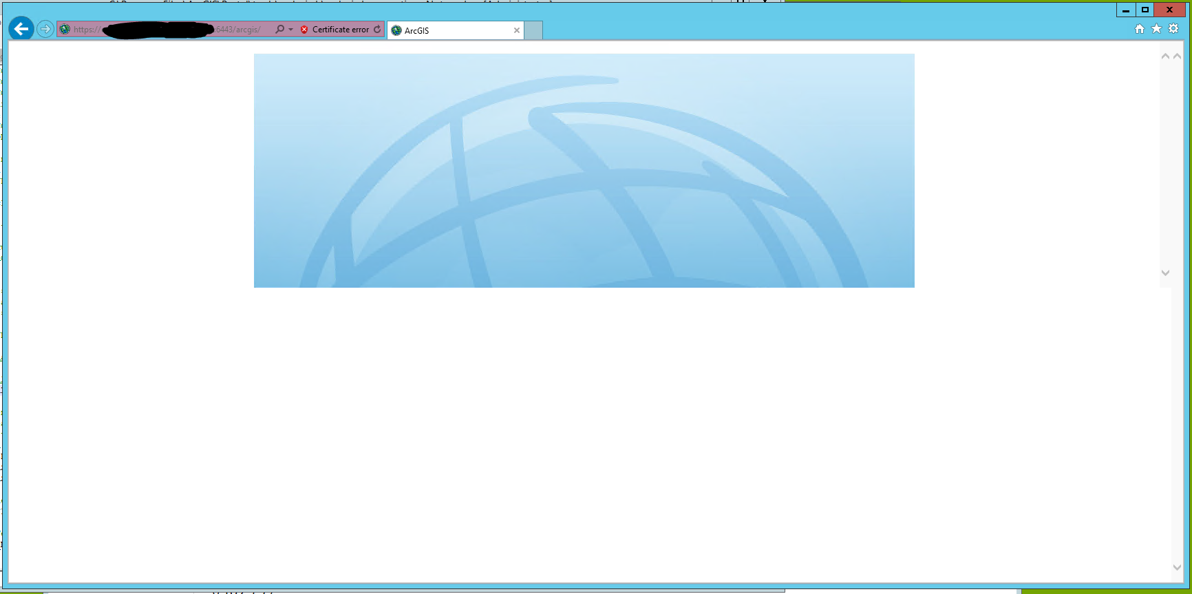

When going to this link, I get the attached screen and nothing happens?

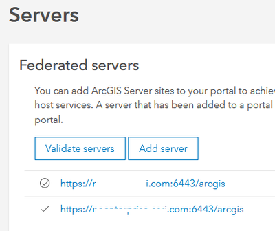

1.  Open a web browser and log into Portal
2.  Go to Organization > Settings > Servers tab
This will perform a validation of your federated ArcGIS Server(s):

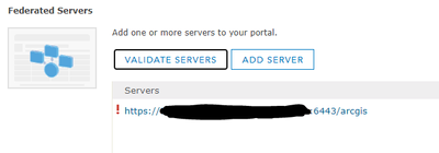

Paul_van_Helden
That is definitely not OK, so going to try to fix this.

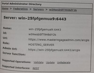

Federation can be tricky, and an incorrect entered URL can keep servers from property communicating. To view federated ArcGIS Server information in Portal Admin, go to Federation | <serverID>. You will see something like the following screenshot.
The two parameters of interest here are url and Admin Url should be the FQDN URL to/arcgis and Admin Url should be internal machine name over port 6443 to /arcgis. Ensure that these are correct; if they are not, you will need to unfederate (via the Unfederate Support Operation) and federated again. Note that re-federating will require changing ownership back to the publisher account, as re-federated services will be owned by the administrator that performed the federation.
