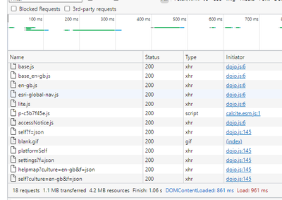

What happens if you use Developer tools. What traces and responses can you see in the Network Tab?

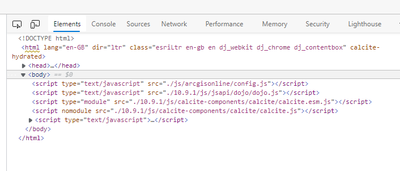

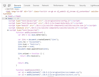

AnthonyRyanEQL
To me it looks normal - No obvious problems/errors
It has elements
Has Network information with all status=200
No errors
