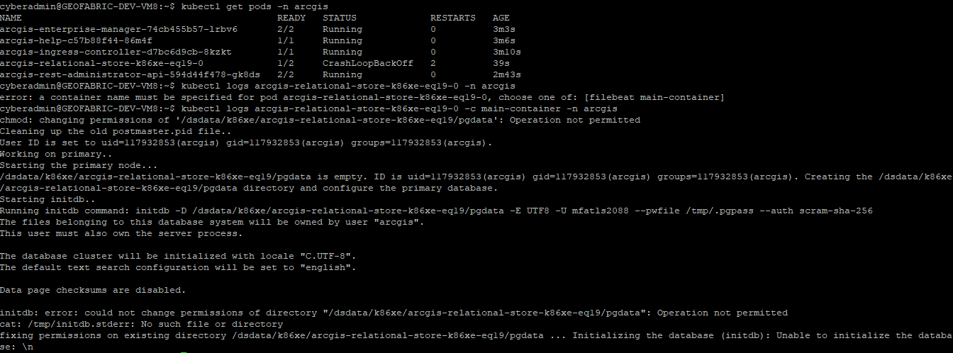

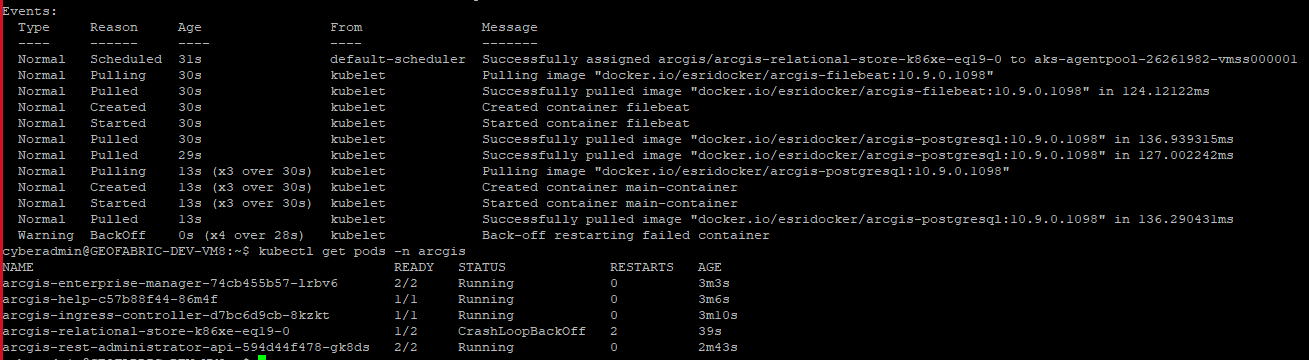

However, when using dynamic provisioning with Azure files, the first pod that comes up fails with a "crashLoopBack" error and the configuration does not proceed forward.

Errors we are getting during configuration:
Logs from the failing container:

From the research I've done on Azure Files, it is using a CIFS mount to access the underlying share. Once mounted, CIFS filesystem permissions cannot be changed from the Linux client. With that in mind, the PostgreSQL initdb process executed when the container spins-up attempts to modify the permissions on the PGDATA location, which is not an allowed operation with Azure Files. With that being the case, there is no Azure Files-based storage class that would allow for PostgreSQL to initialize successfully.
