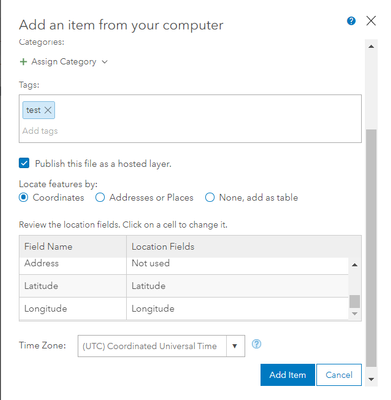

I've used this in both ArcGIS Map and ArcGIS Pro.  In AGOL, you can choose to add a new item (the table containing your latitude and longitude) from your computer, and check the checkbox to publish the file as a hosted web layer.  In this dialogue box, you select the radio button to add the features by coordinates (see image below)
