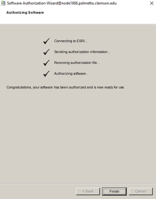

I found the solutions.
The error is not from the installation process but from the authorization process between ArcGIS Server and our computer cluster.
What I did was to login into my.esri.com using school username, create license files and download it. In /arcgis/server/tool/, use the authorization tool to configure the license file with "correct" address that I was registered with ESRI. Once the authorization process done, the following screen appears and I am able to import arcpy using conda environment created in the prior steps

TueVu
