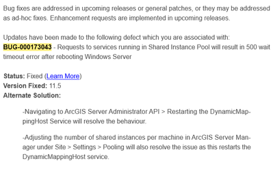

Hey guys, I received an update regarding BUG-000173043. It looks like there's a permanent fix coming in version 11.5. Not sure if there will be a patch in the interim - but I'm hoping.

ESRI support has confirmed the issue we are dealing is related to the same bug. Our automated work-a-round for this was to restart the ArcGIS Server windows service after 10 minutes of windows start-up.
