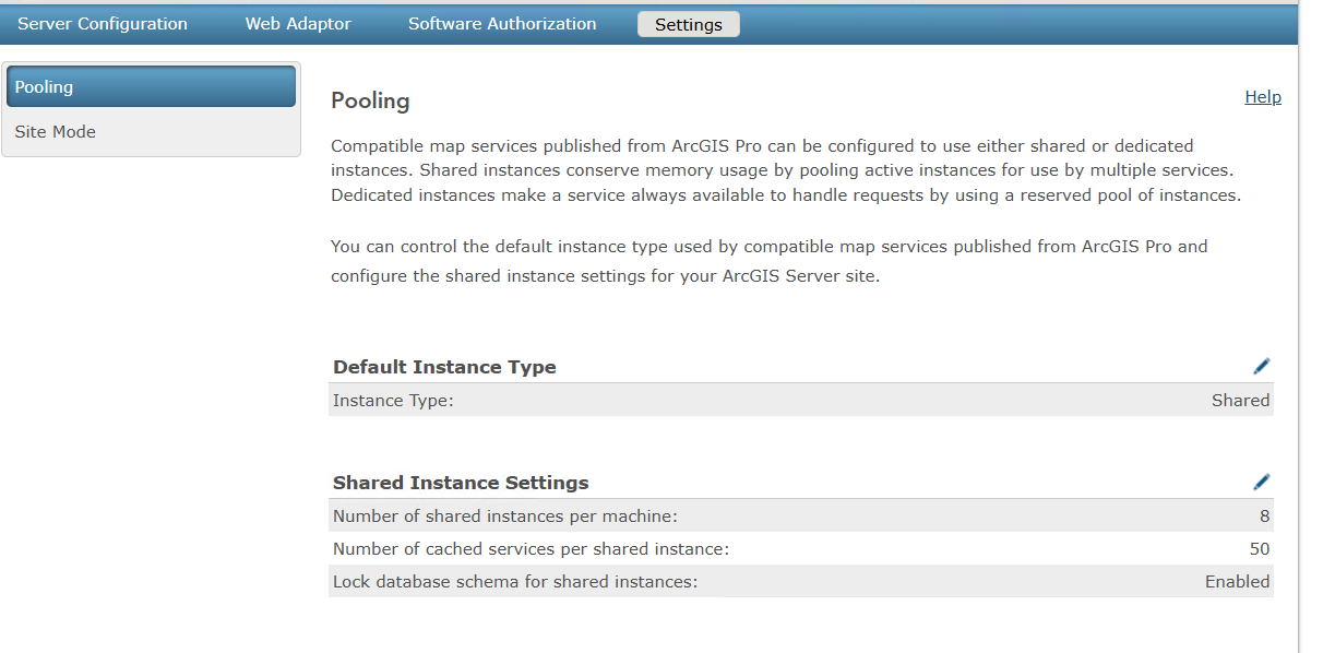

I recently upgraded our environment from 11.3 to 11.4.  I keep up with latest releases as best I can, usually within a month or two. It's not a complicated setup so upgrades are straightforward.  This time, after what looked like a successful upgrade, most of our services were not accessible.
I attempted the upgrade twice with the same result before realizing only the shared instances were not loading or accessible via REST.  I searched for any reason at all why this is happening but found nothing.  On a whim, I changed the settings for our shared instances from 8 shared instances per machine to 4.  For some reason this fixed it.  I even changed it back to 8 and everything is working fine.

Recently upgraded to 11.4 (from 10.9.1). After a scheduled windows server reboot, we had the same issue with services in the shared instance pool not functioning. With the help of Esri.ca Support, was able to get those services running again by stopping and starting the DynamicMappingHost in Server Admin.
I tried rebooting the server again and was able to recreate the issue, but the stop/start of DynamicMappingHost fixed it again... So, I'm now looking to make sure all services in the pool are working properly and that none of them are bogging everything down on system startup.

It was on 8 shared instances per machine while we were on 11.3 and we never had any issues with it. That setting didn't change during the upgrade, still not sure why it choked it up.

Our organization also observed this behavior when upgrading to ArcGIS Enterprise 11.4 from 11.3. We've had an open ticket with ESRI, and one temporary solution was to gracefully stop the ArcGIS Server and restart the ArcGIS Server. This had worked for our staging environment, but not for production.
Our temporary fix was to configure services to dedicated instances, but this is a short-term solution until the issue is addressed appropriately.
I performed the same fix as yourself - decreased the number shared instances per machine from 8 to 4, and then back to 8. This did the trick - great find! Odd, but great find for others that have others that have observed this issue.
tcaulum_WPPI
We have since noticed that every time we reboot the server (once a week for maintenance purposes) the same issue crops up.  It's an easy fix, but if ESRI comes back with a long term solution let me know.  I'm close to opening a ticket with them, as we have to manually reboot the servers now.
