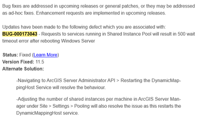

Other than confirming it as a bug @ 11.4, no specific reason provided. Bug has been resolved at 11.5.
We're still actually @ 11.4. The long-term solution that's still working for us was boosting my DynamicMappingHost pool to 8 and staggering service startup by 10 minutes at server reboot (datastore-portal-server).

FYI - through my support case with ESRI last month, it was determined that this was indeed a bug with DynamicMappingHost and logged under BUG-000173043. It's currently "in product plan".
Anxiously awaiting a quick fix to this 🤞.
