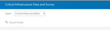

Hello,
Yes you are right, I meant to say creating a join view.  With a join view, unfortunately you cannot add fields. See images.  When the layer is a join view, that's when you have to undo it.  The add, plus sign, in the Critical Infrastructure Data and Survey is missing because I used this layer in a join view.
I did receive instructions on how to undo the join view.  Here it is in the blog - https://doc.arcgis.com/en/arcgis-solutions/latest/reference/configure-police-transparency.htm#ESRI_S....
