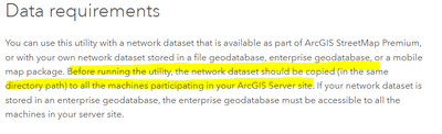

We were able to resolve this issue by creating a copy of the data on both all machines participating in ArcGIS Server Site. Once we did that, the size of service definition files decreased substantially
Then we made minor changes to the script as per our required (Not recommended to do this, try above first )
and fixed the overflow error.
This approach we took based on the documentation:
https://enterprise.arcgis.com/en/server/10.9.1/develop/windows/publishing-routing-services.htm#ESRI_...
Posting this as it might be of help to anyone in future.
