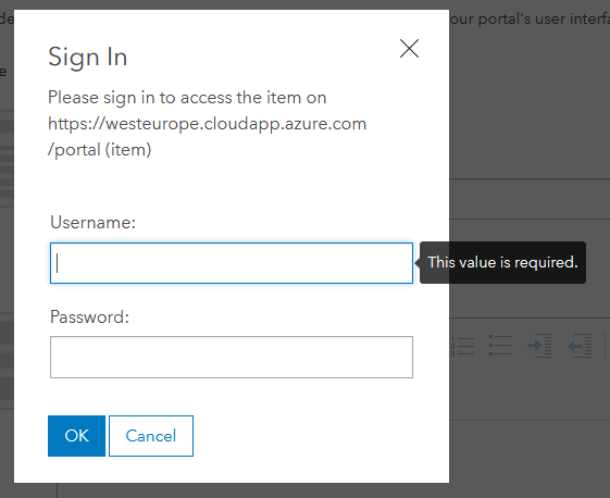

Hello,
i found some weird behavior in an installation of ArcGIS Portal. When trying to access the Settings in the Organization tab i get a login prompt even though I am already logged in. The prompt also shows a wrong URL that is missing the prefix (e.g. portal.westeurope.cloudapp.azure.com/portal).
If i just close the prompt, i can access the site and everything seems to work just fine. But whenever I refresh the page it shows up again. I can also not sign in, but I guess that´s because the domain is wrong.
I did check the WebContext URL as well as the WebAdaptor settings and everything seems to be correct. I also compared the settings with a portal that works fine and could not find any differences.
Anyone has any idea what that might be?
It´s the Portal Version 10.7.1 running in an Microsoft Azure VM with two webadaptors configured (portal and server).
