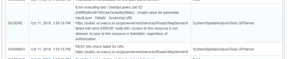

Trying to run the default SpatialAnalysis Tool in Portal 10.6.1. I get the same error message with both web maps and web apps. Both internal and external apps otherwise work correctly (so, basically, they are fine if they don't need to use this tool). ESRI tech support is stumped (though we will continue to try random fixes again next week).
Server error log, permissions, forbidden
And if it helps, pasting the URL directly into a browser does indeed find the page.

Months of tech support calls and we got it figured out. There was an extra slash at the end of the privateHostingServerURL value (under /arcgis/admin/security/config) for both Portal and Server. Removing that did the trick.
This:
.../arcgis/
Should be this:
.../arcgis

TychoGranville
This is a bit past my skillset (and way out of my comfort zone), but if i go in to Server/System Services with the internal URL and submit the job (first image) I still get the same error (second image).
REST script screen
REST script screen
This:
.../arcgis/
Should be this:
.../arcgis
