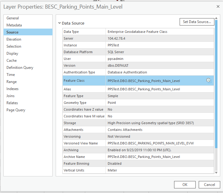

I'm trying to publish a dataset from ArcGIS Pro 2.4.1 to Server 10.7 for use in a Collector app. I've gone through all the steps to turn this into an editable, sync-enabled dataset. The SDE source for the data is registered with the server, I've added global IDs, enabled archiving (data is non-versioned), and enabled editor tracking. I've enabled editing and sync under the configuration pane of Publish Map Service in Pro. The service publishes successfully, but won't start. I see this error in the logs: Failed to construct instance of service 'BESC_Parkin_Main_Level.MapServer'. Layer(s) or table(s) are not configured for Sync. I'm not sure what I'm missing here.

Are there any related tables or attachments? If so, Global ID must be the primary key.
LeviCecil
Yes and yes. These tables were created in the SDE when I enabled all the settings and attachments. I just started from scratch and I'm getting the same error in the server logs.

Just got off the phone with tech support. Apparently this is BUG #000124999. Receiving error message ‘Layer(s) and Table (s) not configured for Sync’ when publishing a feature service to ArcGIS Enterprise from ArcGIS Pro when attachments and editor tracking are enabled.
