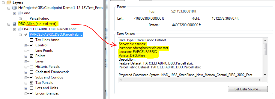

Yesterday I was trying to isolate my parcel fabric SDE database, and actually copied the instance to another virtual server.  When noticing that it was my version and that it still showed that I could reconcile and post my updates, I had expected that I created a one or two way replication.  As this was a test environment I continued to edit in the isolated database.  After I saved my edits I went to the original database with my administrative account and there was no replica created.  Yet all my edits showed up, and no rec-post was performed.  So some how, even though I was on a different server, I was still editing directly to the original SDE database.
One thing that was quite noticeable is that the file performance increased at its new location.
screen capture of copied SDE instance.
In ARC Map, how the data set looks.  It still points to original SDE database.

When you copy/pasted the .sde file, no actual data was moved, since no data exists in the .sde object. Think of that file as simply a reference for the software to find the database. You'll notice in the original and the copy that the instance, database, and user credentials are the same. You are still editing in the original environment. In order to copy the actual data, you'll need to right-click the destination folder, create a new file geodatabase. Go into the .sde connection, right-click the parcel fabric, Copy, then Paste in the new file geodatabase. This will be a static, isolated copy.
