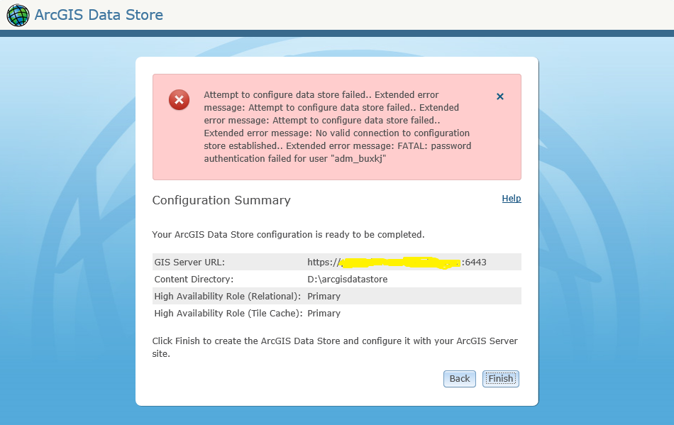

Hi,
I am running Datastore configuration wizard and I get the below error message.
Instillation directory of data store is in C:\Program Files\ArcGIS\DataStore drive and data store content directory I am trying to configure in D drive.
Portal for ArcGIS (10.5) is federated with ArcGIS Server(10.5). I am putting the correct password of ArcGIS Server administrator.

Is this a new install?  Do you have an arcgisdatastore folder under the D:\ drive?  If so, stop the ArcGIS Data Store service, delete or rename the D:\arcgisdatastore folder, start ArcGIS Data Store, and then try again.

MayurDodiya
Hi Jonathan,
Yes, It worked now many thanks  . I did steps you mentioned and datastore register successfully.

It could actually be the content directory you are selecting.   Is D:\ a mapped to a file share or a physical drive on the machine?
If it is a mapping it could be puking on that.  See note under step 4.
Create a data store—ArcGIS Data Store (Windows) Installation Guide | ArcGIS Enterprise
You can set the file store backups to a file share, but the Data Stores have to be on the local machine(s).   If you need high availability, it will require a second machine and set that up as the standby.
This is all assuming it is the content directory.  If not, disregard at your leisure.  🙂
MayurDodiya
Hi Bill,
Thank you so much for your reply. I did the steps Jonathan mentioned and it worked.
