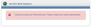

If Portal is down, then you won't be able to access WAB/ExB at all. It depends on what exactly is down, but if your web adaptor is online but Portal is offline, then you will get an error message like this.
