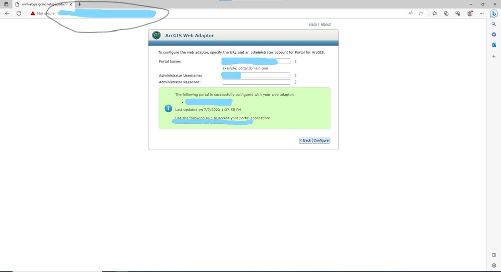

Thank you @ReeseFacendini however, what I meant when I asked: "While installing ArcGIS Enterprise more specifically while configuring WebAdaptor should I configure it over DNS alias or FQDN of WebAdaptor Machine." was should I use DNS alias in the URL address bar or FQDN in the URL address bar.
ReeseFacendini
Esri Alum
It doesn't matter, so long as the page loads. The web traffic will route the same either way.
