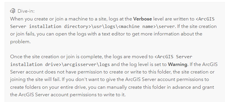

What I would recommend is that we start from the basic to get to the bottom of this issue. Can you check the following :
If can share those logs, I can have a look at them also.

thanks for your response i reviewed all the Considerations before joining a site
but the issue still happening
i will share with you the log file
