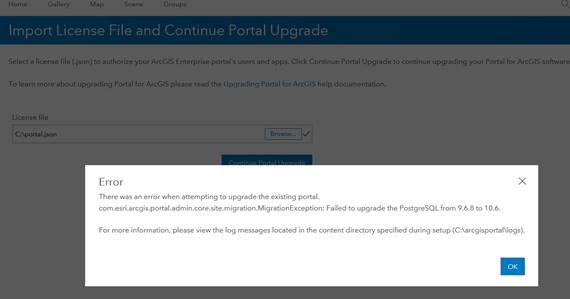

I faced an error while upgrading from Portal for ArcGIS 10.6.1 to Portal for ArcGIS 10.7.
The following error occurred during the upgrade:
Digging into the log in C:\arcgisportal\logs\FQDN\portal, I noticed the following error:
<Msg time="2019-04-25T10:19:54,94" type="INFO" code="209081" source="Portal Admin" process="3436" thread="1" methodName="" machine="FQDN" user="" elapsed="" requestID="">Postgres DB upgrade response
could not open version file: C:\arcgisportal\db/PG_VERSION
Failure, exiting
.</Msg>
As you can noticed, there is a mix of backslash and forwardslash as the file does exist in C:\arcgisportal\db\PG_VERSION but of course C:\arcgisportal\db/PG_VERSION is not a correct path.
Operating System details: Windows Server 2016 Standard
Any idea ?

JonathanQuinn
Esri Notable Contributor
Hm, seems like that'd be a problem, but then any environment upgrading to 10.7 would see that problem. What locale are you using? Try to run ProcMon and filter for that path during the upgrade to see what errors are logged.

NicolasGIS
Honored Contributor
Thanks for the reply.
I do have this phenomena every time I want to upgrade.
I run a clean DSC installation and then try to upgrade and get this error.
Sorry but which path should I look for ?
Thanks

JonathanQuinn
Bugs/issues don't get fixed unless there are specific patches to address them, so waiting to install the same version will still present the problem.
That error isn't something specifically addressed even at 10.7.1 so it sounds like it may be an environmental type problem that we'd need to get to the bottom of. We run through a significant amount of upgrade testing and never ran into this, which points more to something specific within those environments.
