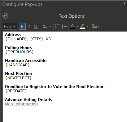

- Created a web map in Pro. Configured the pop-up using the text option:

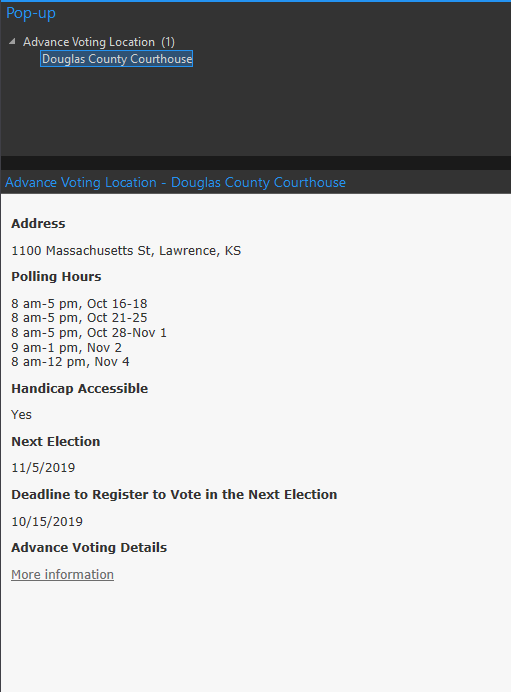

- Successfully tested the pop up in Pro:

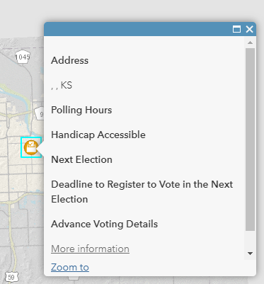

- Added new layer to a web map. Clicked on point and got this:

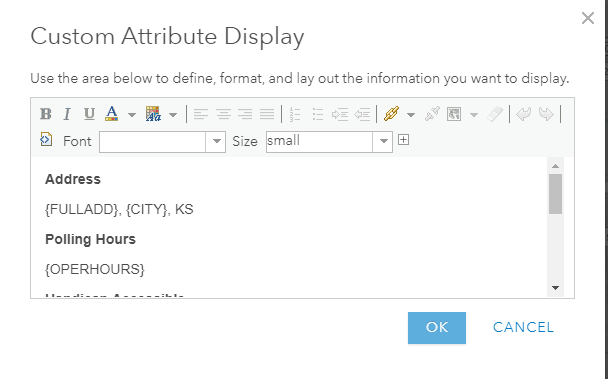

All of the dynamic fields that should be pulling from the attribute table are left blank. I checked the pop-up configuration in the Portal web map, and it looks right:

I answered my own question mere minutes later.
When you create the pop-up in Pro, do not remove the Fields option. Just add in the Text configuration and leave the Fields as-is.
I had deleted the Fields option (circled in red) before I published. If you have a Text option, it will be used for your Portal web map pop-ups.

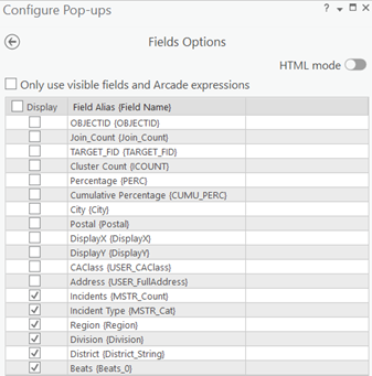

I see the solution. I do not see how to apply it to my screen.
I am ARC Pro 2.8.2.
Here the config pop up screen looks like:
the instructions for the Text option do not tell me much
"Add custom text to the pop-up, including hyperlinks. Standard text formatting options are available. Optionally, turn on HTML Mode to further enhance the text." That option opens a new window that seem sot need a lot of typing. Nor does it seem to allow re formatting of a number to have, in my case no decimal places.

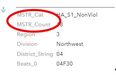

Note that I had formatted the screen to change the name of the field. At the web map map, I had already re-configured the the incident to remove the 6 unneeded decimal palaces, then noticed it was ignoring my labels:
Granted I now have to reconfigure 24 layers at the web. Fortunately pop up configuration at the web is less obtuse.
