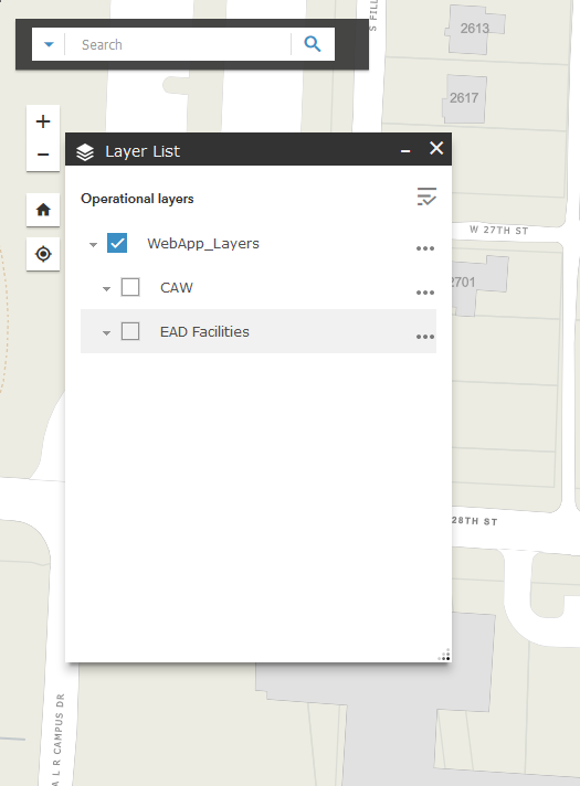

This is what we get in the web app.  Notice the 2 layers in the TOC are expanded and there is nothing there (no symbols).

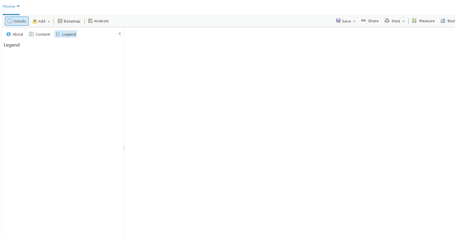

When I try to open the source web map in Portal, from the map details page, I get a blank map.  Nothing.

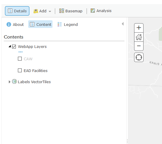

If I open the map from the Recent Maps dialogue get this, which look like the web app.

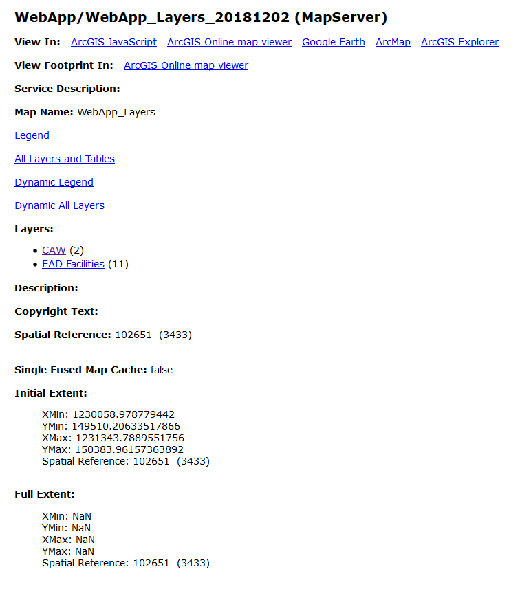

When I go the REST endpoint for the web map.

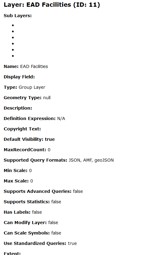

When I go the REST endpoint for one of the still listed layers

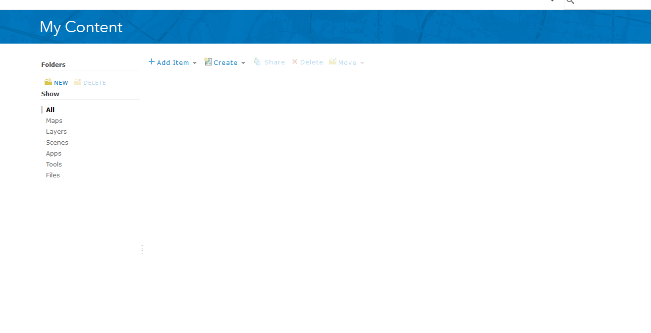

And when I go into My Content
