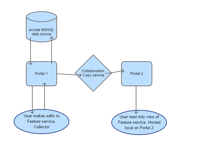

The only way I can seem to get collaboration copy to work is if I select copy all data during the  generation of the source feature service.  If I copy all of the data than any web edits to the feature will not propagate to the arcsde server. the edits apply to a local hosted copy on the portal.
So long story short is there a way to get it to copy from a reference feature service?  I am basically trying to create an automated read only version for public view vs a in house editable view that points to the sde database.

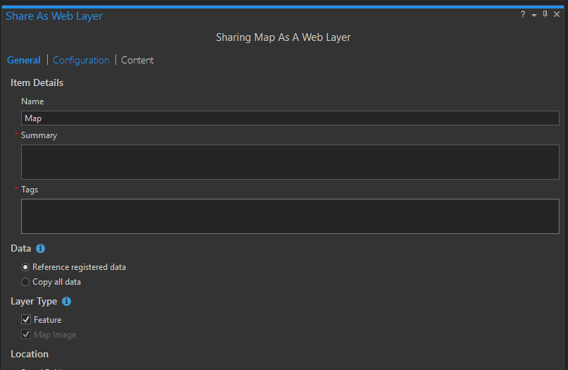

Hi Jared,
Yes you will be able to share the feature layer (from your Enterprise GDB) as a copy to Portal 2, you just need to ensure the feature layer is sync-enabled before publishing from Pro to Portal.
See the documentation below:
Share feature layers from an enterprise geodatabase—Portal for ArcGIS (10.6) | ArcGIS Enterprise
Hope this helps!

Thank you Joel for the response, I was able to get the workflow finally. My battle now is with getting it to work with attachments.  From what I can tell I have followed all the guidance.  Gloabal IDs etc.
Do you think that workflow will work with attachments?
