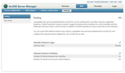

Do you have access to the ArcGIS Server manager menus? I'm curious what your settings are for Site > Settings > Pooling
IreneEgbulefu1
Yes, I do and here is a screenshot of the page

  1. Since your default instance type for new services is "dedicated": How many services do you have on the server.
  2. What are the default min./max. number of instances for a services ?
  3. Does the Windows Service run under a Domian User, a Windows Managed User or under "local System"
Usualy ArGIS Server only spins up a SOC if there is a request to a service. So either there are a lot of request generated somewhere or maybe something prevents the server from shuting down the SOCs.
