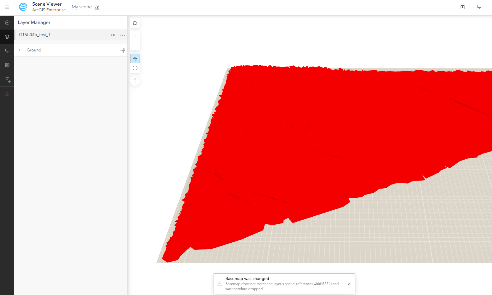

Hello Community,
I have a SLPK file contains a MESH data and I want to share as a scene layer on ArcGIS Enterprise.
The scene layer displays correctly when I share the SLPK file as a hosted scene layer. but, scene viewer does not display correctly if I create a scene layer from eslpk (Extracted Scene Layer Package) which is extracted from same SLPK file using extract package geoprocessing tool in ArcGIS Pro.
Has anyone else faced a similar problem?
- ArcGIS Enterprise version 11.4
- ArcGIS Pro 3.5.3

Just a thought, is this a recent problem?
One key thing at Enterprise 11.4 is that the Tile Cache Datastore was replaced by the Managed Object datastore and so I would be curious to know if this used to work or if it works on other .eslpks
David
