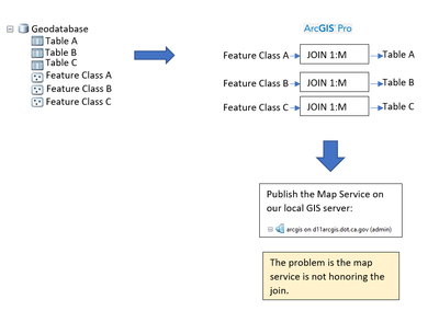

YasnaiaMassie
Here is an illustration what I've been doing which is not working.
TanuHoque
thanks @YasnaiaMassie for providing the illustration.
how do you know map service is not honoring the join? Do you see fields from the joined table in the layer REST resources? if you submit a query request with outFields=*, do you see all fields from left and the right side of the join in the result?
