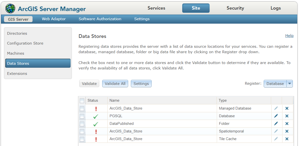

Our hosted ArcGIS Enterprise 10.6 system started showing errors after a Windows Server 2016 update. There are validation errors against Managed Database, Spatiotemporal and Tile Cache as shown in below picture:
In the Logs tab, I notice following two messages:
SEVEREMar 29, 2020, 6:29:26 PMThe connection property set was missing a required property or the property value was unrecognized. Instance not available on serverDataValidator.GPServer
WARNINGMar 29, 2020, 6:29:14 PMFailed to validate the data store machine 'URL'. 'Server machine 'URL' returned an error. 'Invalid Token.''Admin
Appreciate if someone could direct me in the right direction. Thanks
Farakh

It sounds like there is an issue with the relation data store. I would recommend running the 'describedatastore' utility. This returns status information regarding data store. Based on the error messages and the validation failures server may be unable to communicate with data store.
