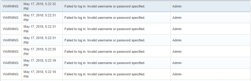

QiranLiang
I keep getting this warning that said "Failed to log in. Invalid username or password specified." Although during that time nobody is trying to login at all.
This warning will appears every 5 seconds or so and it never stop. Anyone have any idea why it happens?

You'll need to do a bit of digging outside of the Server. Check the logs on whatever is in front of the Server, (web adaptor or reverse proxy). If you're using the web adaptor, the IIS logs will have the IP address of where the request originated. If it's an internal, then you have something/someone to check on. If it's external, you may have to block the IP address.
