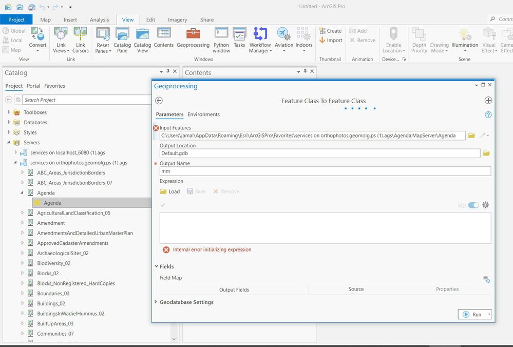

This appears not to work in Pro. The “export feature” option is deemed!
What might be the issue here?

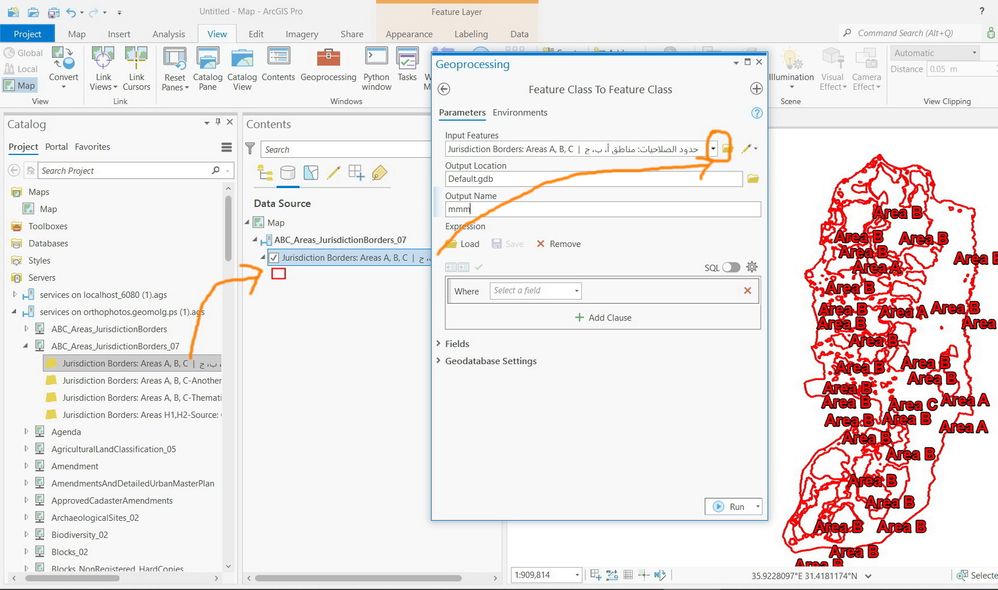

Add the data from the service on your map and then use the feature class to feature class tool.

KrystinaHartwell1
You have to add the layer from the service to your TOC. The tool should have a drop down to select the layer as an input feature when it has been added to your TOC.

It works like a charm! Thank you KrystinaHartwell1
