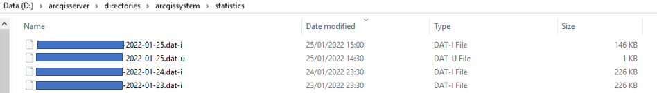

So I've found the place where the statistics are actually saved:
Location of files ^. Although at first menacing, both the .dat-i and the .dat-u files turned out to be structured like csv's.
Sample .dat-i ^
Sample .dat-u ^
