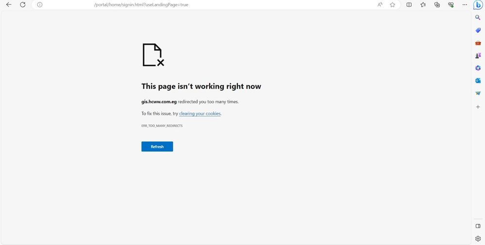

I cant Reach login page to ArcGIS enterprise
2045
10-12-2023 03:15 AM
AhmedTarek123
I Configured ArcGIS Enterprise  But I cant Login in Sign in page WhatsApp Image 2023-10-12 at 13.09.58_254dac6d.jpgWhatsApp Image 2023-10-12 at 13.09.58_497e3786.jpg

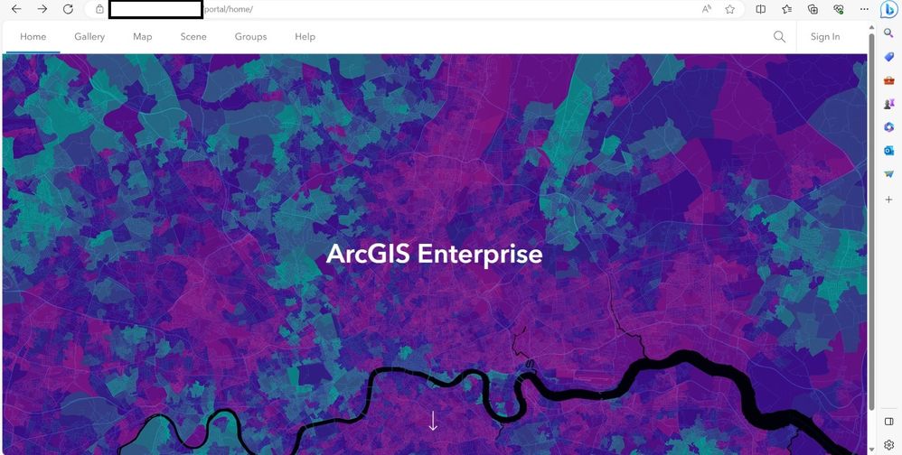

I have a ticket open with ESRI for the exact same issue.  I can reach the sign in page if I go through the port 7443. If I try the web adaptor it times out.  They believe its either a proxy setting or certificate issue.
