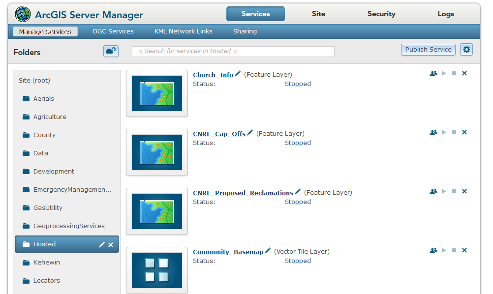

Step 1 of migrating a machine running Server is to move the server directories and configuration store to a shared network location.  After performing this step, all of our hosted feature classes no longer work.  In Server Manager, the hosted feature classes are shown as "Stopped":
I've tried restarting Portal, Server, Data Store, and the original Single Tier machine.  None of those worked.

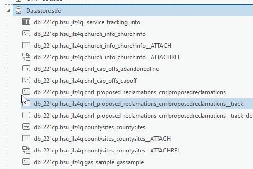

If I connect directly to the DataStore database using Pro, all of my feature classes are there, and if I add them to a map, the data is still there as well:
Any idea what I need to do to get these services working in Portal/Server again?

DavidColey
MVP Frequent Contributor
Have you tried using the python api to start the services?  From time to time, some of my hosted feature services or vector tile services will 'stop'  I restart them using the python api.  Something like:
try:
    gis = GIS("https://yourdomain.net/portal", "your_portal_login", "your_portal_pw")
    gis_servers = gis.admin.servers.list()
    print(gis_servers)
    #message = message + "\n" + str(gis_servers)
    agshost = gis_servers[0]
    print(agshost)
    #message = message + "\n" + str(agshost)
    vtServicesList = agshost.services.list(folder='Hosted')
    for vtService in vtServicesList:
        serviceName = vtService.properties.serviceName
        if (serviceName == 'ExoticInvasiveSpeciesPoint' or serviceName == 'ExoticInvasiveTreatment'):
            print(serviceName)
            message = message + "\n" + str(serviceName)
            vtService.start()
            print(vtService.status)
            message = "\n" + message + "\n" + str(vtService.status)
except Exception:
    # If an error occurred, print line number and error message
    import traceback, sys
    tb = sys.exc_info()[2]
    e = sys.exc_info()[1]
    #print(e.args[0])
    #print "Line %i" % tb.tb_lineno
    message = message + "\n" + "Line %i" % tb.tb_lineno
    message = message + "\n" + str(e)
works for me every time I encounter a stopped hosted service.
Hope this helps
