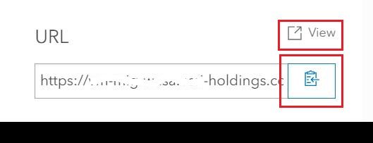

It seems like the connection to the service is no longer working.   To check if this is the case, go to the Item page in Content, and scroll to the bottom of the page.  To the lower right, you will see URL. Copy the URL and paste it into a browser's address bar.  You should see the service REST end point. Alternatively, click the View button to the right of URL:

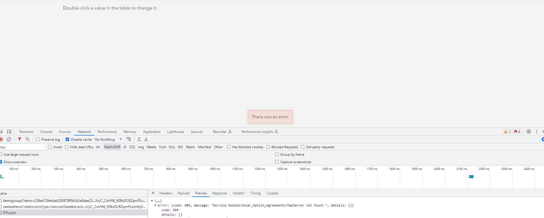

When I checked the URL on browser, it shows as 404 error and haven't changed anything since it published.
when I try to browse same thing in arcgis web services, service was listed in arcgis services
