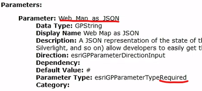

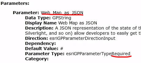

I have been comparing this tutorial with other ESRI learning source such as ESRI video (13:04). I found that this tutorial uses "Optional" for "Web_Map_as_JSON" in parameter setting of the script tool whereas the video uses "Required" for "Web_Map_as_JSON" parameter (please see screen shot below). A0328_0-1635726180287.png
As ESRI's tip in the tutorial says that we can leave the input parameter for Web_Map_as_JSON blank, the script tool won't run successfully if I change the parameter to "Required".

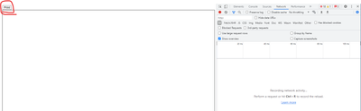

Do you mean a print button for the "Next hit the print button" is this one? I did hit but it did not happen anything.

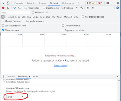

Although I was not sure if this is the one you meant, I also changed the setting of "Emulate CSS media type" to "print". But it still does not show the details of the request parameters. I guess I am not doing what you mentioned...

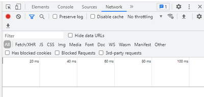

Actually, the first picture is the one with the print button in my html application. while the developer tool is open, I hit the print but it did not happen anything.
LongDinh
The JavaScript code is not working. The request appears to never have been sent.

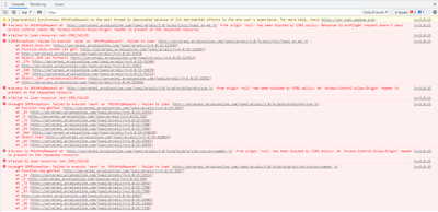

Check the console tab to see if anything has been logged.

I have opened the console but don't understand the messages unfortunately.

The console error appears to not accept your machine's domain. You can enable it following this https://enterprise.arcgis.com/en/portal/latest/administer/windows/restrict-cross-domain-requests-to-...
