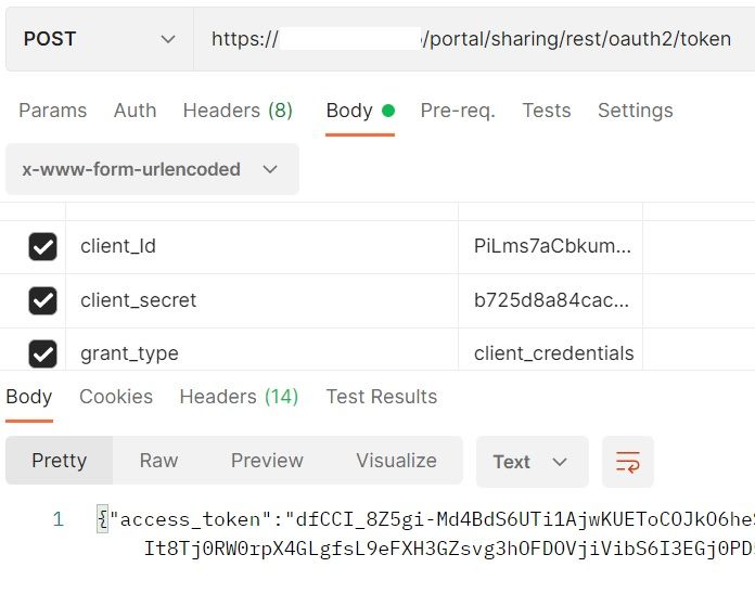

Below I generate a token using oauth2 application credentials:

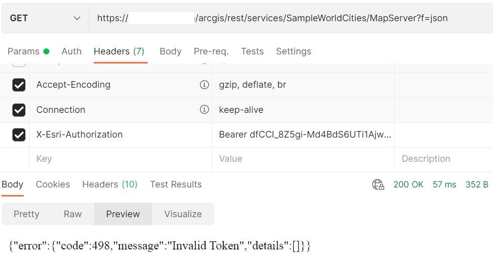

After that I try to use the token to get the information from the ArcGIS REST Services Directory main page from a service that is shared privately, as a json response and get the error 'Invalid Token':

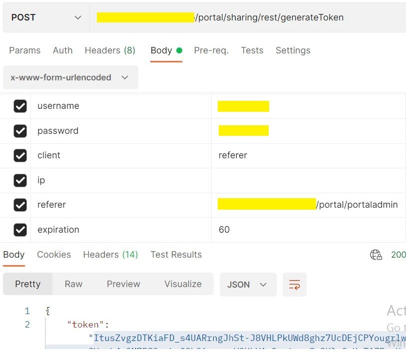

So I managed to create a valid token using the generateToken endpoint:
I was using client=ip or client=requestip instead of client=referer and this was generating a token that wasn't valid. Still having problems generating a token with oauth2, app login. Can someone please provide an example?
